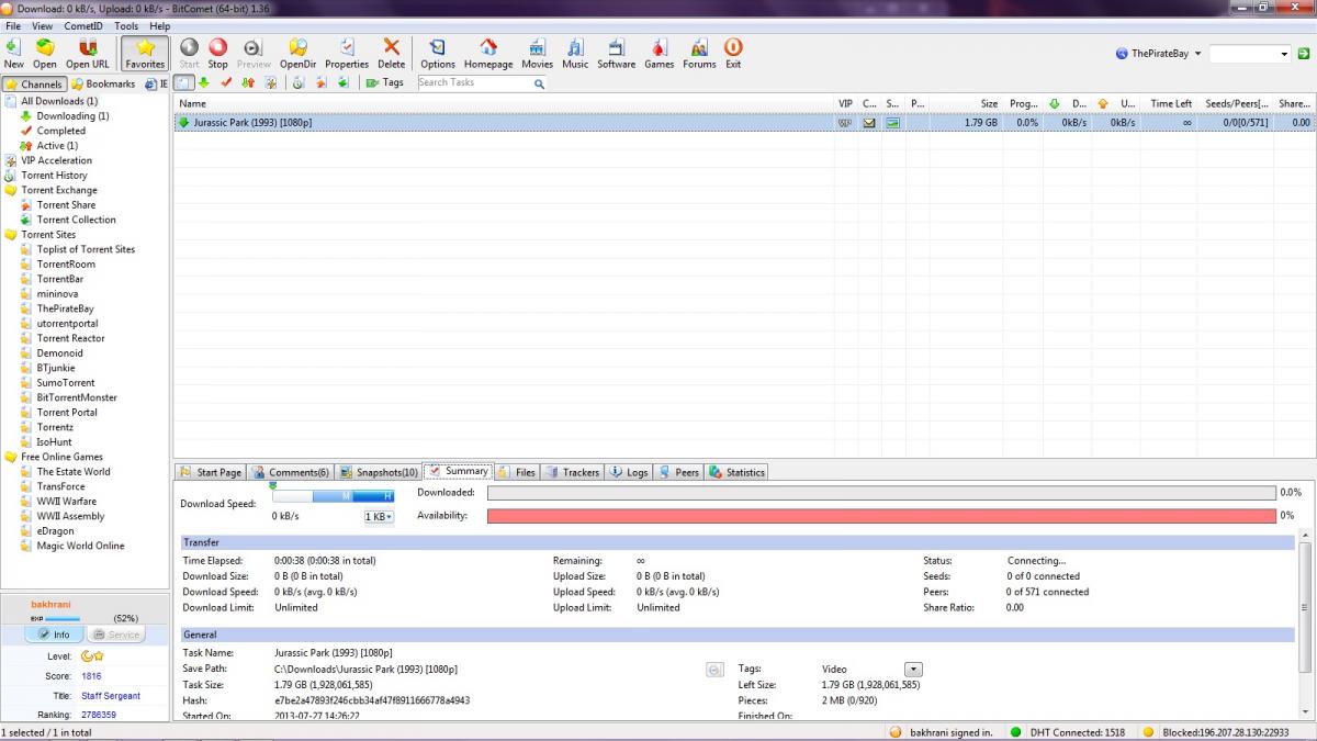

bakhrani Posted July 25, 2013 Share Posted July 25, 2013 (edited) When I try downloading anything from torrent using bitcomet (64bit) 1.36, it's forever showing connecting and no availability for the download. I am using a D-LINK router DIR-605L, Firmware Version : 1.13, and I have forwarded the port. I am using Windows7 Ultimate 64bit and the antivirus I am using is AVG Internet Security 2013. Please help, I have also checked that both antivirus and computer firewall allow bitcomet. Edited July 25, 2013 by bakhrani (see edit history) Link to comment Share on other sites More sharing options...

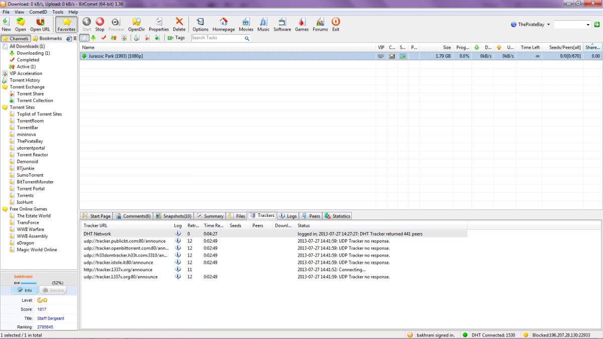

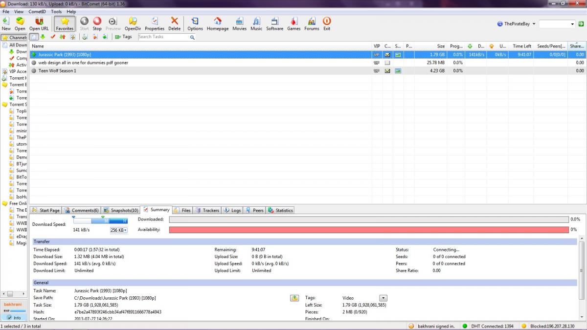

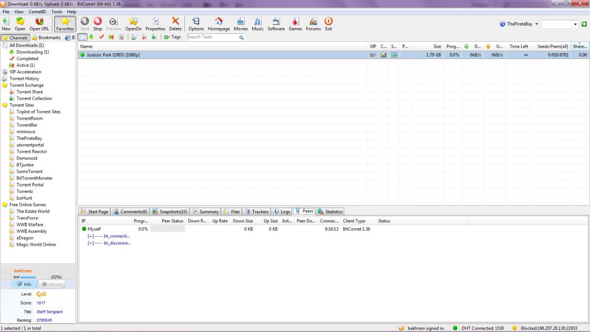

greywizard Posted July 25, 2013 Share Posted July 25, 2013 How about some screenshots of Bitcomet with the Trackers, Peers and Summary tabs selected ? Link to comment Share on other sites More sharing options...
bakhrani Posted July 27, 2013 Author Share Posted July 27, 2013 (edited) Edited July 27, 2013 by bakhrani (see edit history) Link to comment Share on other sites More sharing options...
The UnUsual Suspect Posted July 27, 2013 Share Posted July 27, 2013 That torrent is showing 0seeds, without seeds it will never download. Try another torrent. Link to comment Share on other sites More sharing options...
bakhrani Posted July 28, 2013 Author Share Posted July 28, 2013 I have tried downloading many other torrents, but it won't download. I searched for the solutions, and the only answer I got is firewall is blocking the bitcomet, but I checked the firewall,I also checked the antivirus and I also included an exception through the router. Link to comment Share on other sites More sharing options...
The UnUsual Suspect Posted July 29, 2013 Share Posted July 29, 2013 Perhap you can post similar screenshots of a torrent that has seeds? Link to comment Share on other sites More sharing options...
bakhrani Posted July 29, 2013 Author Share Posted July 29, 2013 (edited) I tried dowloading other stuff but it still has the same problem, and when I am disabling listening mode its downloading but without connecting to seeds. When I set any port and click 'apply', it gives me an error message 'can not listen to port'. Edited July 29, 2013 by bakhrani (see edit history) Link to comment Share on other sites More sharing options...
