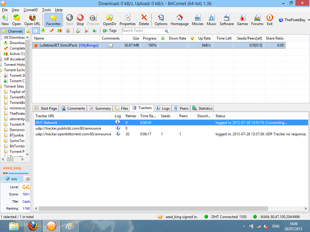

The UnUsual Suspect Posted July 28, 2013 Share Posted July 28, 2013 ps. I did try your torrent and it's showing no seeders. I'm also unable to establish a connection with you. I suspect this might be interference from your isp (talktalk) who is known to be hostile to p2p. It's also possible you have something on your system or router that is blocking udp connections, I see your trackers tab is showing no connection. It also appears you may have LTseed option disabled, it would be interesting to see if the torrent would work using LTseed protocol, it wouldn't be recognized as bittorrent and may not be blocked. Link to comment Share on other sites More sharing options...
seed_king Posted July 28, 2013 Author Share Posted July 28, 2013 ps. I did try your torrent and it's showing no seeders. I'm also unable to establish a connection with you. I suspect this might be interference from your isp (talktalk) who is known to be hostile to p2p. It's also possible you have something on your system or router that is blocking udp connections, I see your trackers tab is showing no connection. It also appears you may have LTseed option disabled, it would be interesting to see if the torrent would work using LTseed protocol, it wouldn't be recognized as bittorrent and may not be blocked. Thats because i closed BitComet, sorry i have started it back up now and my torrent task is now running, can you try it again please Link to comment Share on other sites More sharing options...

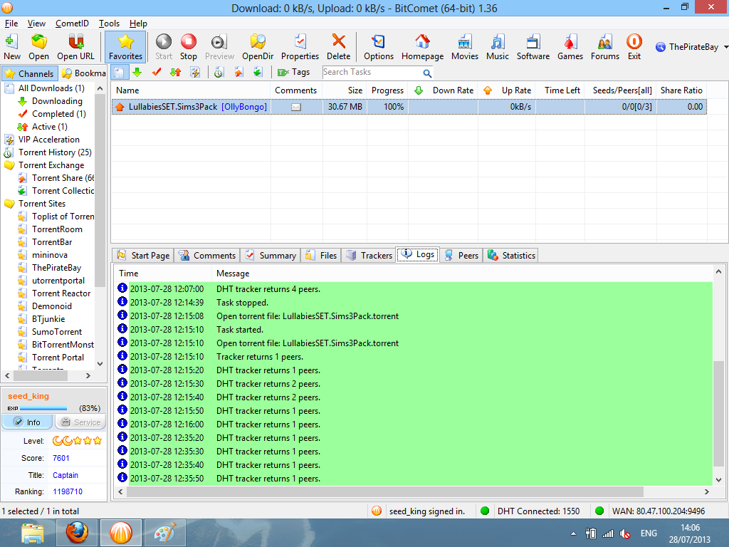

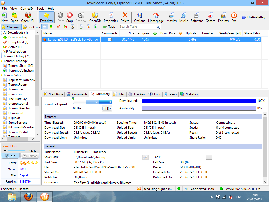

seed_king Posted July 28, 2013 Author Share Posted July 28, 2013 i had to send the screenshot in a pm it didnt work here, did you get it edit by staff: no screenshot was in the PM. Please try hosting the screenshots on a site like photobucket or similar edit 2: I added one of the screenshots from your photobucket here using this code... [img=http://i1332.photobucket.com/albums/w611/Olly_Wright/screenshot3_zps3182ab49.png] Link to comment Share on other sites More sharing options...

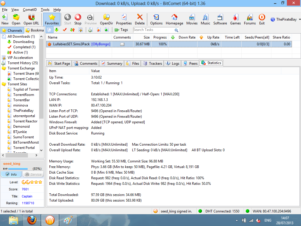

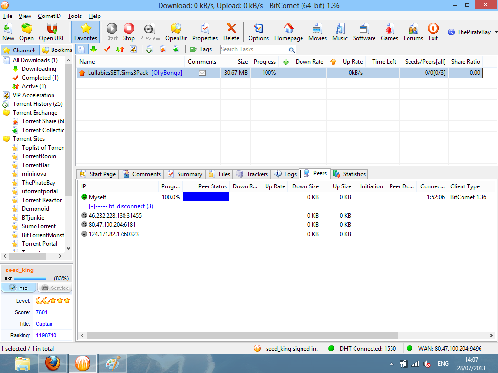

seed_king Posted July 28, 2013 Author Share Posted July 28, 2013 but there is 0 out of 0 downloading how is it working my latest screenshot below Link to comment Share on other sites More sharing options...
seed_king Posted July 28, 2013 Author Share Posted July 28, 2013 it looks like only you managed to download my torrent as the only ip address on my peer list on the screenshot above is the only one downloaded i think, have a look dude Link to comment Share on other sites More sharing options...
The UnUsual Suspect Posted July 28, 2013 Share Posted July 28, 2013 I see in the screenshot that I added to your post above that you do have LTseed enabled on this task, but also make sure you have it enabled in your global options. I'm not seeing any LTseed peers listed so it's possible this option is disabled. When using LTseed it will allow you to trade outside the bittorrent swarm. This can be very helpful in some circumstances, but be aware that your tasks will continue to upload when stopped, but only if there is unused bandwidth available. Link to comment Share on other sites More sharing options...

The UnUsual Suspect Posted July 28, 2013 Share Posted July 28, 2013 If you look at your tracker data there is only two peers, you and me. Don't pay much attention to dht data, it's often inaccurate because much of the connections are just to spread the hash table, not necessarily peers interested in downloading. Link to comment Share on other sites More sharing options...
