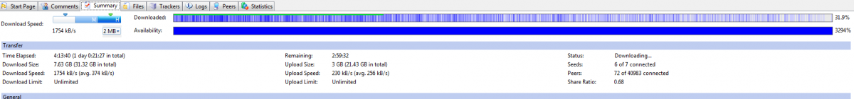

ZarafFaraz Posted February 27, 2014 Share Posted February 27, 2014 (edited) I've been having this issue as of late where a download will finish, and then restart back at 0%. It's really annoying when I finish a 20 gig torrent only to have it restart and have to wait many hours for it to finish again. Does anyone know why this happens and how to stop it? In the screenshot below, please note the stats versus the values in parentheses. It's the current versus the running total from the restarting. Edited February 27, 2014 by ZarafFaraz (see edit history) Link to comment Share on other sites More sharing options...
The UnUsual Suspect Posted February 27, 2014 Share Posted February 27, 2014 When it reaches 100% bitcomet does a hashcheck to confirm all the data is intact, this is probably what you are witnessing. The hashcheck progress is displayed in the same column as the download progress but it will progress much faster. If you did have some type of error that caused it to crash and restart, you can stop the task and do a manual hash check and resume from your current level of progress. Link to comment Share on other sites More sharing options...
ZarafFaraz Posted February 27, 2014 Author Share Posted February 27, 2014 I'm familiar with the hash check, the icon is yellow while that is happening. This is not what I'm talking about. My download actually resets back to 0% and restarts all over again. Why would the stats of that torrent be the way they are in the above screenshot if not for a restarted torrent? Link to comment Share on other sites More sharing options...

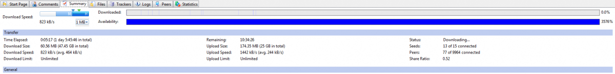

ZarafFaraz Posted February 27, 2014 Author Share Posted February 27, 2014 Ok, so it just happened again with this torrent. Oh, and this has happened to me with other torrents as well, not just this one. This is the second repeat: Link to comment Share on other sites More sharing options...
