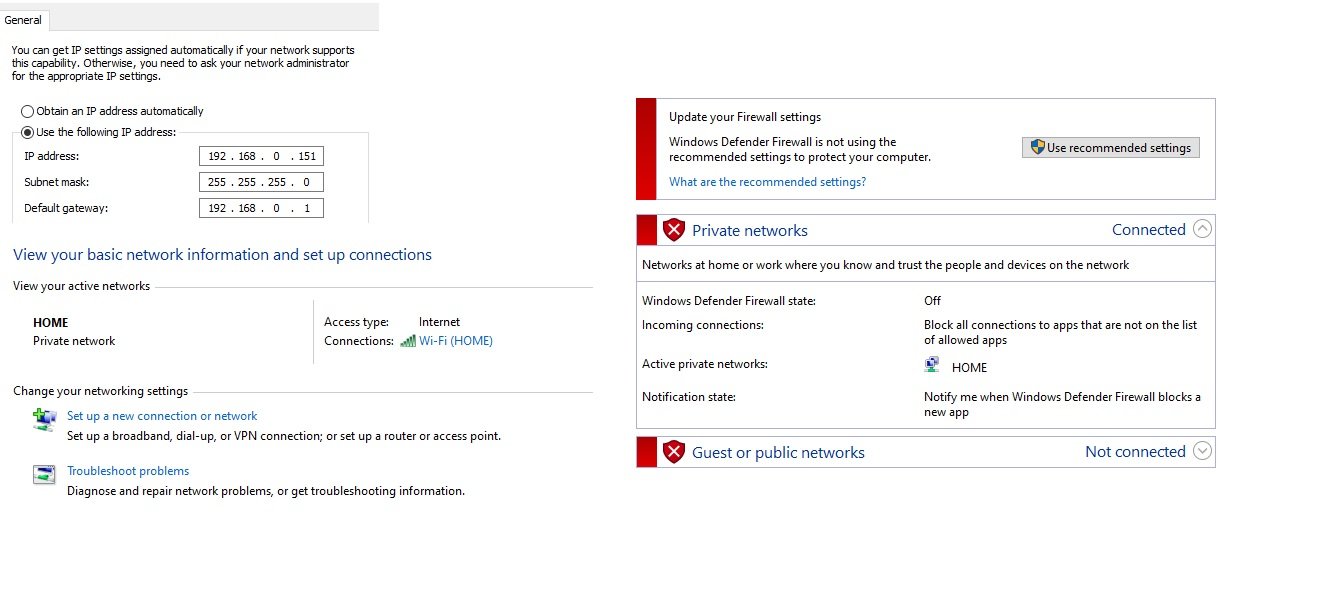

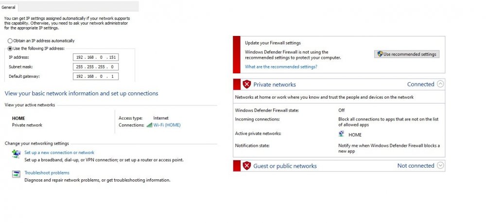

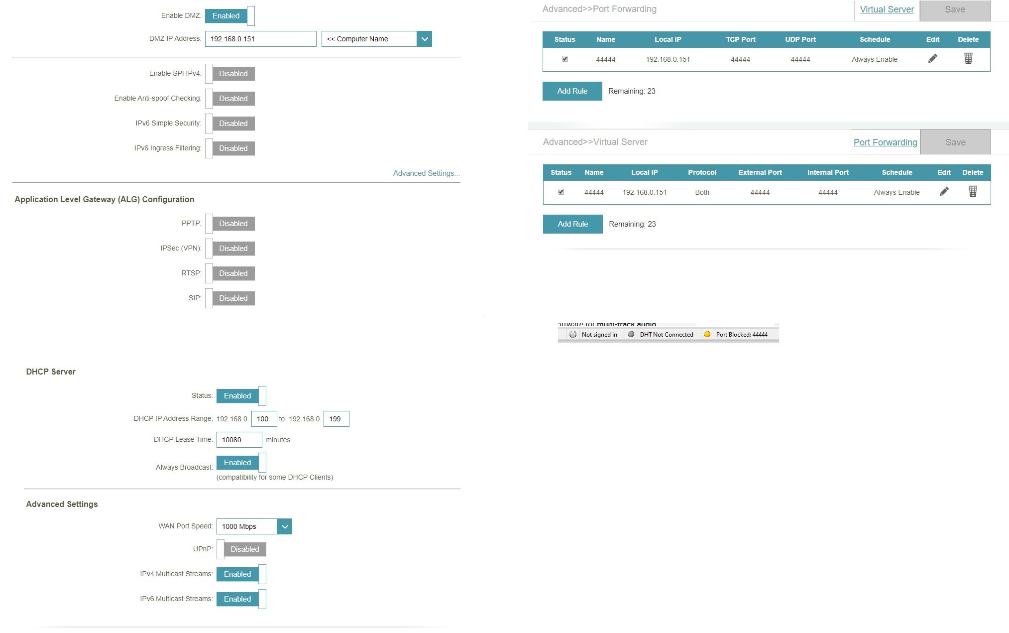

blocked_ports Posted April 30, 2020 Share Posted April 30, 2020 (edited) hi, can you please help with ports have tried i believe everything staitc ip is set for both router and pc, port forwarding/virtual server to 44444 port, dmz on, upnp off win 10 firewall disabled 44444 is still blocked provider->router->my pc's, no any other devices such as modems or similar d-link dir-882 attached few screenshots please help Edited April 30, 2020 by blocked_ports (see edit history) Link to comment Share on other sites More sharing options...
Rhubarb Posted April 30, 2020 Share Posted April 30, 2020 Try disabling the DHCP in the router and also try lower ports (in the 15,000 range). You could also try turning on UPNP and maybe with the DMZ disabled. Any or all of a combination of those. by the way, necro-posting (adding a 'me too' to a long dead thread) is never a good idea. We don't charge for new threads Link to comment Share on other sites More sharing options...
blocked_ports Posted April 30, 2020 Share Posted April 30, 2020 On 4/30/2020 at 4:13 PM, Rhubarb said: Try disabling the DHCP in the router and also try lower ports (in the 15,000 range). You could also try turning on UPNP and maybe with the DMZ disabled. Any or all of a combination of those. by the way, necro-posting (adding a 'me too' to a long dead thread) is never a good idea. We don't charge for new threads Expand have changed all possible settings, appreciate any other thoughts Link to comment Share on other sites More sharing options...
