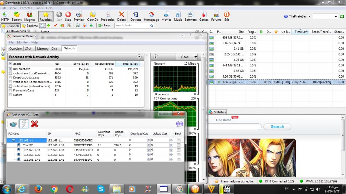

Hammadymn Posted February 23, 2016 Share Posted February 23, 2016 Hi .. i,m using bitcomet for 3 years by now with the score 4741 and everything was just fine v1.40 64x .. 1m.b internet connection and a dlink router recently downlading tasks became very slow .. i tried to find whats wrong and ifind that bitcmet is uploading something at he same time and giving the priority to upolad .. even when i,m not downlodnig it keeps doing that as long as it is in the background .. I did disable LT-Seeding option but yet nothing changed any help i can use ? Link to comment Share on other sites More sharing options...

Hammadymn Posted February 23, 2016 Author Share Posted February 23, 2016 yes I know .. thats normal my mai proble is when i am downloading a u can see n the sceenshot this was not happening in the past Link to comment Share on other sites More sharing options...
The UnUsual Suspect Posted February 23, 2016 Share Posted February 23, 2016 it's hard to tell from your screenshot what you have running or what you've selected to display since you have the other apps obscuring half the gui, but the title bar show the gross upload and download, this will include data, LTseed and overhead communications and currently it's reading only 1kB/s for upload and download. Link to comment Share on other sites More sharing options...
GandalfTheWizard Posted February 23, 2016 Share Posted February 23, 2016 @Hammadymn Please take a screenshot to BitComet only. Since you're using a router, you might need to forward your listening ports. Link to comment Share on other sites More sharing options...
Hammadymn Posted February 27, 2016 Author Share Posted February 27, 2016 it's hard to tell from your screenshot what you have running or what you've selected to display since you have the other apps obscuring half the gui, but the title bar show the gross upload and download, this will include data, LTseed and overhead communications and currently it's reading only 1kB/s for upload and download. i did show those apps to give details about how bitcomet uses my bandwidth .. task manager performance monitor and a net control app .. and they show how bitcomet still uses upload even when LTseed is disabled and without showing that in the gui itself @Hammadymn Please take a screenshot to BitComet only. Since you're using a router, you might need to forward your listening ports. here is the max speed i got on my router .. 125kbps http://www.picpaste.com/Untitled2-iweeMkyI.jpg and here is the max using 3G .. 855 kbps even with a blocked port !!! http://www.picpaste.com/Untitled5-jNRhbIrk.jpg going back to router .. it doesnt last long and uploading begins to eat my bandwidth but it doesnt show in the gui .. i can know it using those apps in the original post screenshot http://www.picpaste.com/Untitled6-jqMvvtuy.jpg even when i stop the task .. i cant browse the net probably until i exit bitcomet completly hope to find some help about that Thanks Link to comment Share on other sites More sharing options...

The UnUsual Suspect Posted February 28, 2016 Share Posted February 28, 2016 Looks to me like the problem is the settings, You've got your max upload set to 10kB/s which is an extremely bad idea. It should be set at 80% of your max (tested) upload speed, but first try setting it at unlimited and see if that fixes the problem, then run a speedtest with nothing else using your internet and make sure you are measuring in KB/s not kb/s and set to 80% Link to comment Share on other sites More sharing options...
