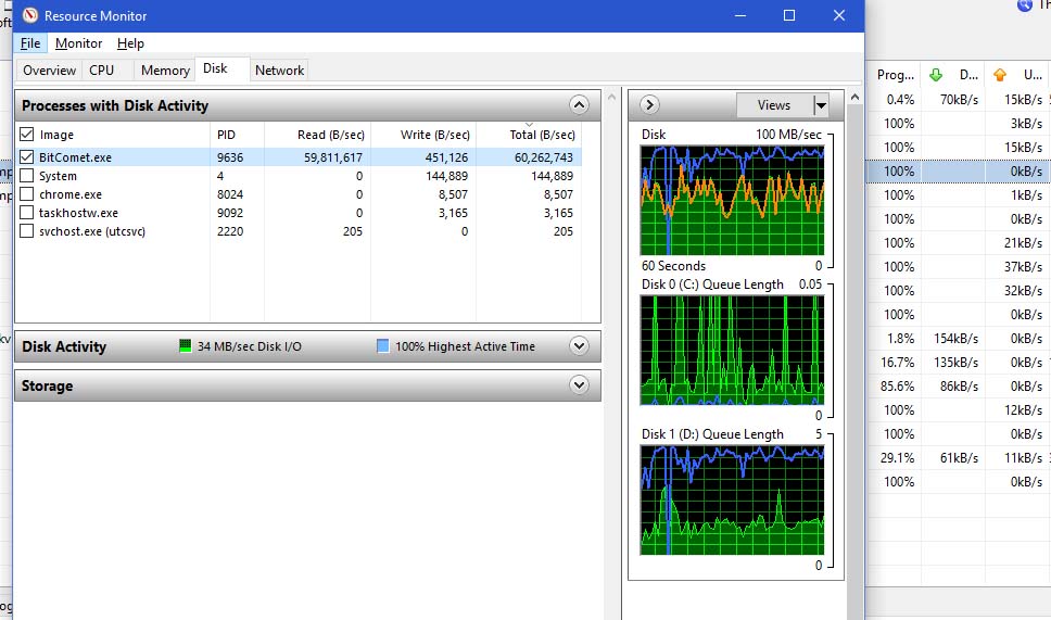

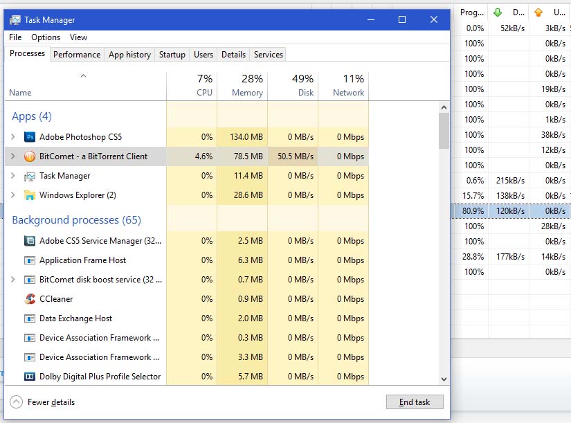

AnonymousPreferred Posted May 20, 2016 Share Posted May 20, 2016 Hello! I'm running 64-bit BitComet 1.40 (installed from the HTTP download on bitcomet.com). On Windows 10, I've noticed that BitComet lags after it's been running for a while: it takes a long time (up to 10 seconds) to respond to the mouse. Sometimes, the BitComet icon will disappear from the taskbar, but the process will still be running because nothing happens when I try to open BitComet until I end the process using the Task Manager. I decided to check the Task Manager when BitComet was lagging, and it showed anywhere between 30MB/s to 55MB/s of disk activity from BitComet: As you can see in the above image, my download and upload rates totaled less than 1MB/s at the time, so I'm not sure what all of the extra disk activity is for. I opened the Resource Monitor in an attempt to figure out what BitComet was doing, and it would seem that BitComet is reading an unnecessary amount of data from my hard drive: I'm pretty sure this is a bug because it happens almost every time on Windows 10, but I've never had it happen on Windows 7. Maybe I'm stupid and it's just a problem with my configuration, but I haven't changed any of the BitComet options (other than changing the listen port for port forwarding), so I don't think that's the case. Link to comment Share on other sites More sharing options...
GandalfTheWizard Posted May 20, 2016 Share Posted May 20, 2016 Go to Tools > Options > Disk Cache and change the default settings to these ones: Min disc cache 50 Max disc cache 1024 Shrink disc cache if free mem lower than 500 Cache size for HTTP 2048 These options will store cached data on RAM and prevent disk overload. 1 Link to comment Share on other sites More sharing options...
The UnUsual Suspect Posted May 20, 2016 Share Posted May 20, 2016 the recommended settings will vary depending on how much ram memory you have installed. The default is to assume you have a minimal amount of ram so disc cache size is very small. By increasing you prevent excessive use of harddrive, but will use more ram memory. 2 Link to comment Share on other sites More sharing options...
AnonymousPreferred Posted May 21, 2016 Author Share Posted May 21, 2016 Ah, that seems to have fixed things! Thanks! Sorry for the false alarm; I just got a new laptop and I'd never had these issues before on my previous (windows 7) one, so I assumed it was yet another "program not working properly on Windows 10" issue. Link to comment Share on other sites More sharing options...
GandalfTheWizard Posted May 21, 2016 Share Posted May 21, 2016 the recommended settings will vary depending on how much ram memory you have installed. The default is to assume you have a minimal amount of ram so disc cache size is very small. By increasing you prevent excessive use of harddrive, but will use more ram memory. I assumed his laptop has a lot of memory since he is running Phhotoshop, BitComet + Windows's servicies and only 28% of RAM are being used. Link to comment Share on other sites More sharing options...
