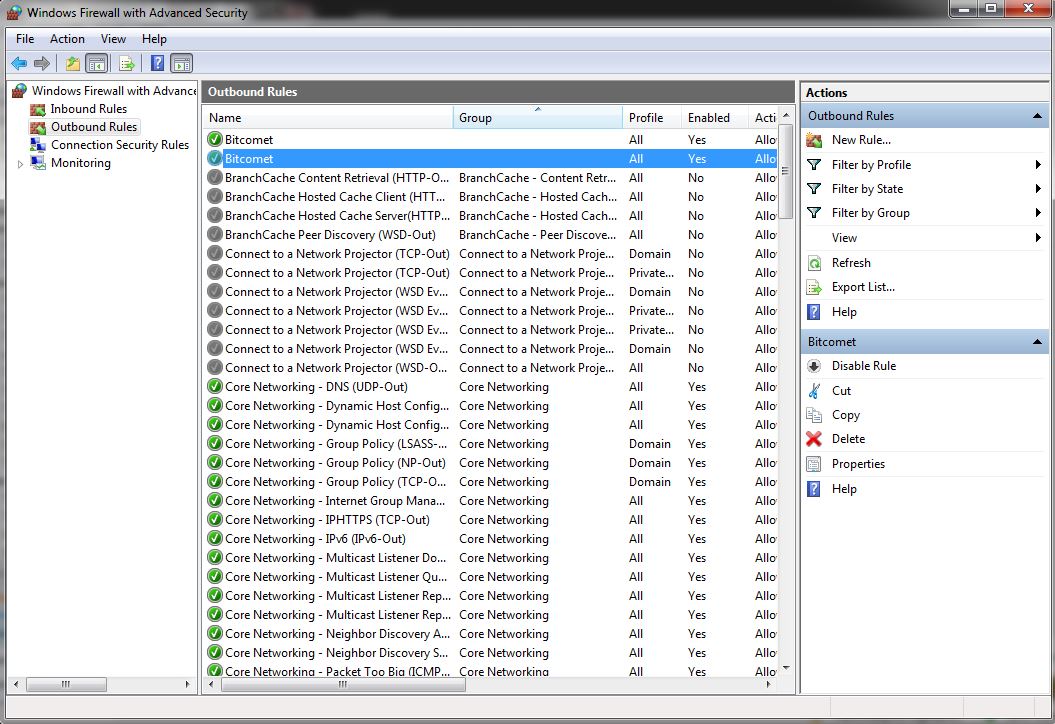

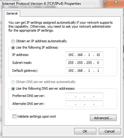

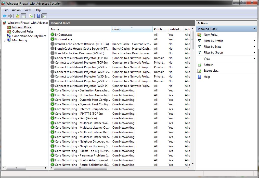

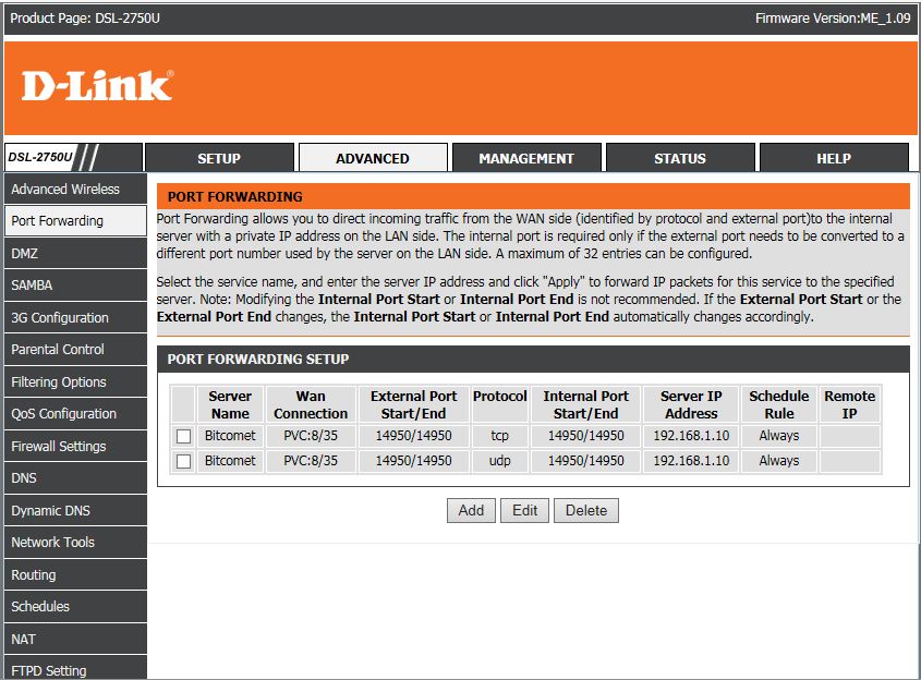

Hammadymn Posted July 9, 2016 Share Posted July 9, 2016 (edited) Hi all Dell laptop connected to 1 M.B ADSL internet by lan to D-link router with a static IP Windows 7 64x .. using Bitcomet 1.40 64x for 2 years ( with some updates ) Port 14950 forwaded manually and firewall exception is made .. UPnP mapping disabled Trust and allow rule made in Kaspersky Internet Security 2016 Everyhing was just fine for 2 years with a green light .. last month bitcomt began to show me a yellow light .. I tried re-forwarding port and that did not help .. I left it as it is . a few days ago the green returned by itself .. ok .. good for me .. without any change.. the yellow light is back yesterday .. I checked everything again .. tried another ports and forwarded them .. went back to firewall and kaspersky rules .. and at last I unistalled Bitcomet 1.40 an installed the new 1.42 I found ..STILL .. yellow light Any help please ? Reards Edited July 9, 2016 by Hammadymn (see edit history) Link to comment Share on other sites More sharing options...
The UnUsual Suspect Posted July 11, 2016 Share Posted July 11, 2016 it looks to me like you've done everything right, but check your LAN IP and make sure it matches the one you setup in your last screenshot. Sometimes windows will restart with a different IP and foul up your port settings. Also if bitcomet starts with windows it may fail the port check before your router has time to open the port, but if you "right click" on the yellow light you can test again and see if it then reads as open. Link to comment Share on other sites More sharing options...
Hammadymn Posted July 14, 2016 Author Share Posted July 14, 2016 My IP is static .. Forwarded as it is to the router with the port and bitcomet does not start up with windows Link to comment Share on other sites More sharing options...
The UnUsual Suspect Posted July 15, 2016 Share Posted July 15, 2016 When your light is yellow, retest it and see if it changes to green, if not, make sure your LAN IP in windows matches the IP in your port forwarding setup. I also recommend you test the port manually using "canyouseeme.org", if they cannot see you when your listening port is tested while bitcomet is running, then something is blocking your incoming connections. I'm also concerned why you have your upload set at 10KB/s, with such a low setting you won't be very successful at gathering peers. Ideally you want this setting at about 80% of your max upload. Link to comment Share on other sites More sharing options...
