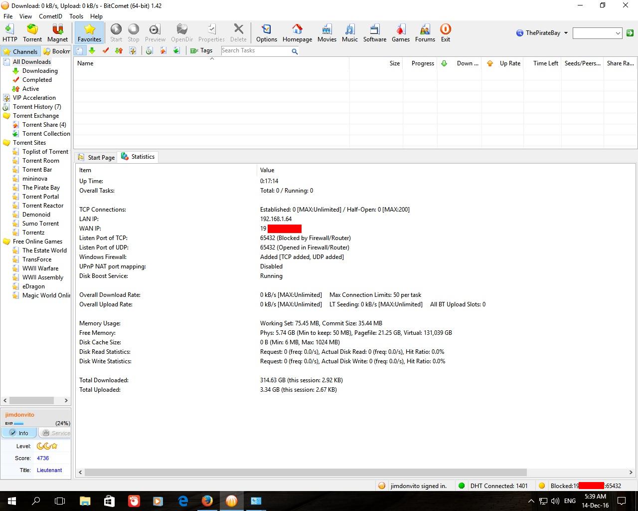

jimking Posted December 13, 2016 Share Posted December 13, 2016 Hi all friends of the community.I use Bitcomet for some years without problem.I download with very good speed for my connection.(My line stats 1020up / 13703down kbps and my speed is always 1,5 mb/sec) However last 3 days my port is blocked.However and this is strange i can still download with top speed between 1,4 and 1,5mb/sec so its very strange.I didn't download any program except some games.I use windows 10 and my router is a Technicolor TD5136V2.My port is open and i also have an exception on firewall,nothing changed since my old good setup. Any suggestions guys? Thanks in advanced. Link to comment Share on other sites More sharing options...

jimking Posted December 14, 2016 Author Share Posted December 14, 2016 (edited) I tried your suggestion with no luck.Here is my stats.Bitcomet is reading my wan ip instead of the static i use thats why its blocked and i can't find a solution.And yes after 20 years im using a pc i feel so noob.:) Edited December 16, 2016 by cassie Edited screenshot (hid I.P. address) (see edit history) Link to comment Share on other sites More sharing options...
Rhubarb Posted December 14, 2016 Share Posted December 14, 2016 change your port number and set up the router port forwarding to the new number (and remove that screen dump and blank out your wan IP address before you get hit with a script kiddy) Link to comment Share on other sites More sharing options...
jimking Posted December 14, 2016 Author Share Posted December 14, 2016 12 minutes ago, Rhubarbfian said: change your port number and set up the router port forwarding to the new number (and remove that screen dump and blank out your wan IP address before you get hit with a script kiddy) I already did it.No progress.And i dont have any firewall and no antivirus. PS theres no way to edit my previous picture. Link to comment Share on other sites More sharing options...
Rhubarb Posted December 14, 2016 Share Posted December 14, 2016 (edited) There should be an edit function - posting yout IP address is even worse than posting your e-mail. If you are using Windows, you may find that the built-in forewall has kicked in (you can set BC to bypass that). You could try a fresh install and see if that works (if you copy the bitcomet folder from C:\User\name\appdata\roaming your actual .torrent files are in there. One other possibility is your ISP is blocking the port (they can do that). Try changing it to something in the 14,000 to 15,000 range but it MUST match the port forwarding in the router IM our resident tame eagle and ask him to delete the post (hopefully before some idiot catches it) Edited December 14, 2016 by Rhubarbfian (see edit history) Link to comment Share on other sites More sharing options...

jimking Posted December 14, 2016 Author Share Posted December 14, 2016 (edited) My port is still block.Since i can still download with my maximum speed i'll stop here and if i make any progress i will post an update to this strange issue.Thanks Rhubarbfian for your suggestions. Edited December 14, 2016 by jimking (see edit history) Link to comment Share on other sites More sharing options...

The UnUsual Suspect Posted December 15, 2016 Share Posted December 15, 2016 Some pointers when dealing with blocked ports. First step is to confirmed the port is actually blocked and it's not just bitcomet's test that is blocked. One easy way to test is at canyouseeme.org. If they confirm your port is blocked then it's likely you have a bad setting on your firewall, router, or other security software. If you suspect the problem is in your router, the easiest way to confirm is to bypass the router (as a test) if possible. Plug directly into your modem and see if the port is now open. If it is, you have a problem with your portforward setting. One common issue if the port worked but suddenly became blocked is your LAN IP address may have changed. Confirm the lan IP listed in bitcomet matches the IP in your portforward setting. In some cases rebooting can change your lan IP address. Your ISP can change your WAN IP, but that won't matter unless they have inbound connections blocked. Note: if you have mobile broadband from a cellular provider they are almost always blocked because it's not a full internet connection, so in these cases the only cure is to get a full internet connection, or just live with the fact that remote peers will not be able to connect to you. Also note that you could have more than one thing blocking you, you could also have more than one router and not even know it which is common when your internet is provided with phone or tv service through a device which are often also a router. Regarding BitComets port test. When you start bitcomet it will attempt to contact our server which will in turn attempt to send a connection to your computer, if it gets through your light will turn green (active test), if it fails the light will turn yellow. If the server cannot be reached it will indicate grey, meaning test was not done. If you have a yellow light and one or more of your tasks acquires remote peer connections the light will turn to green (passive test). This is one of the best testing systems offered by any client, but it's not perfect because it requires on a remote server working and requires you are able to connect to it. IP filters like peerblock/peerguardian/protowall etc can interfere with this process because some block lists don't like programs that "call home", so if you use any block lists you can get a list of the IPs that bitcomet uses on our wiki site at wiki.bitcomet.com to make an allow list. Link to comment Share on other sites More sharing options...
