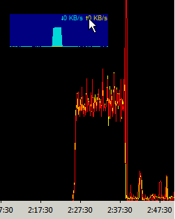

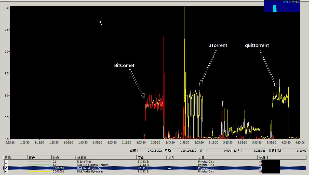

Lin Lin Posted January 8, 2020 Share Posted January 8, 2020 (edited) [Synopsis] As BitComet downloads, it produces disk read activity at the same speed as download speed at that time. [Setup] BitCometBeta 20191225 [Steps to reproduce] 1. Set upload speed limit to a very low value such as 10KiB/s; 2. Download a popular torrent with BitComet; 3. Observe disk activity with any monitoring tool, such as perfmon or HWiNFO; 4. Repeat the above steps with qBitorrrent 4.1.9.1 and uTorrent 2.2.1. [Actual behaviour] As BitComet downloads, it produces disk read activity at the same speed as download speed at that time. As shown in the perfmon screenshot below, the red line(Disk Read Bytes/sec) is almost overlapping with the yellow line(Disk Write Bytes/sec) [Expected behaviour] BitComet should not produce disk read activity at the same speed as download speed. The disk I/O rate graph should look like this: (qBittorrent 4.1.9.1) Notice that the the red line(Disk Read Bytes/sec) stays near the bottom. Or this: (uTorrent 2.2.1) Notice that the the red line(Disk Read Bytes/sec) stays near the bottom. [Uneducated guesses] uTorrent has an advanced option named diskio.smart_hash enabling piece hash calculation from cache before a finished piece is written to disk, thus avoiding re-reading the same piece back from the disk. I wonder if it's related or not? If BitComet does not possess a similar feature it would most probably cause the above described behaviour. Thank in advance! Edited January 13, 2020 by cassie Update images (see edit history) Link to comment Share on other sites More sharing options...
Lin Lin Posted January 11, 2020 Author Share Posted January 11, 2020 (edited) This issue has been acknowledged by the developer and fixed in the latest build. [1.64 beta2 - 20200110] @Rhubarb How to add [SOLVED] to the OP title? It's not possible to edit after 30 minutes. Edited January 11, 2020 by Lin Lin (see edit history) Link to comment Share on other sites More sharing options...
