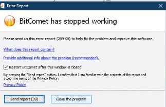

At this point I try to Exit the application and the icon on the task bar turns gray. When I hover the mouse above it I get the notification "Bitcomet Exiting ..." and this continues for about 10 minutes.
After that the following "Not Responding" window opens up:
I choose "Yes" to end the program.
The following window then opens up:
I choose to "Send the report".
This cycle repeats every time I start Bitcomet and it ends nearly always with the "Not Responding" window. Only in the case in which Bitcomet runs for a short period of time of 30-40 minutes there is a graceful exit.
