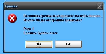

Until today I was using v. 1.09. Today I installed 1.14 hoping that this stupid and annoying error will disappear but… it’s still in the program. Here’s a screenshot of the error which I’ll try to translate for you:
http://usera.imagecave.com/rado84/bitcomet-error.jpg
An error came up in the time for application. Would you like to debug? Line of error: 1. Error: Syntax error.
This error is present in BC since 0.85 by my observations. And I don’t know what’s causing it - in 1.09 it appeared when I tried to stop simultaneously a few tasks from downloading. In 1.14 it comes immediately after clicking on BC’s shortcut on the desktop, even without doing anything specific. I mean that when BC starts this error appears. I have to click “NO” twice to make the message go away and when I click anywhere on BC it comes again. :frowning: I did a complete unistall (using Total Uninstall 4) and then reinstall but this problem remains.

I also do not understand your phrase, “An error came up in the time for application”. The translation does not make sense.
You also indicate that whatever this is, is offering to let you debug it. This is also an indication that an interpreter is attempting to run a program, presumably one which in turn runs BitComet.

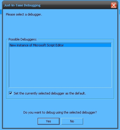

If that’s the case, try answering it “yes”, you’d like to debug, and post a screenshot of the debugger that should appear next. That may help us to figure out what’s happening.

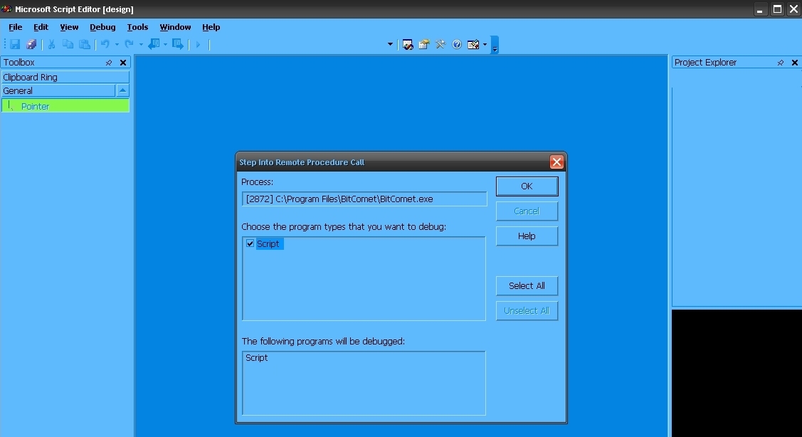

I have no idea what are you talking about. All I know is that this error message appears only when BC is working. Below are the images you required and about the translation - it makes no sense in my language either, so I apologise for the nonsense I wrote.
/monthly_08_2009/post-42044-125038571107.jpg" rel=“”>
/monthly_08_2009/post-42044-12503857184.jpg" rel=“”>
/monthly_08_2009/post-42044-125038572608.jpg" rel=“”>
That helps.
Somebody, at some point, installed Visual Studio’s Just-In-Time debugger. Installing it presumes it was done by a programmer who I have to hope knows what they’re doing. Whoever did that is who you need to go to, and have them fix this.
Whatever you’re doing that you think is supposed to start BitComet, is starting up a web browser that is attempting to go to a web site named “inside.bitcomet.com” (which is not any part of the BitComet organization.)
This startup application tries to load a javascript program from that site which does not exist, which in turn brings up the debugger query.
This is not a standard part of BitComet, and someone has obviously been mucking about with your system at a pretty sophisticated level. Have whoever that is repair what they’ve done.
