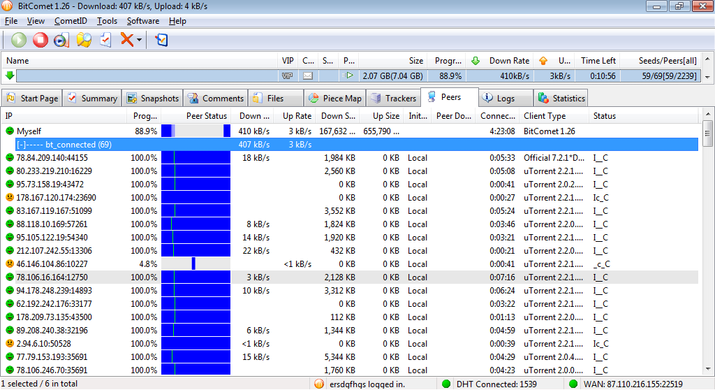

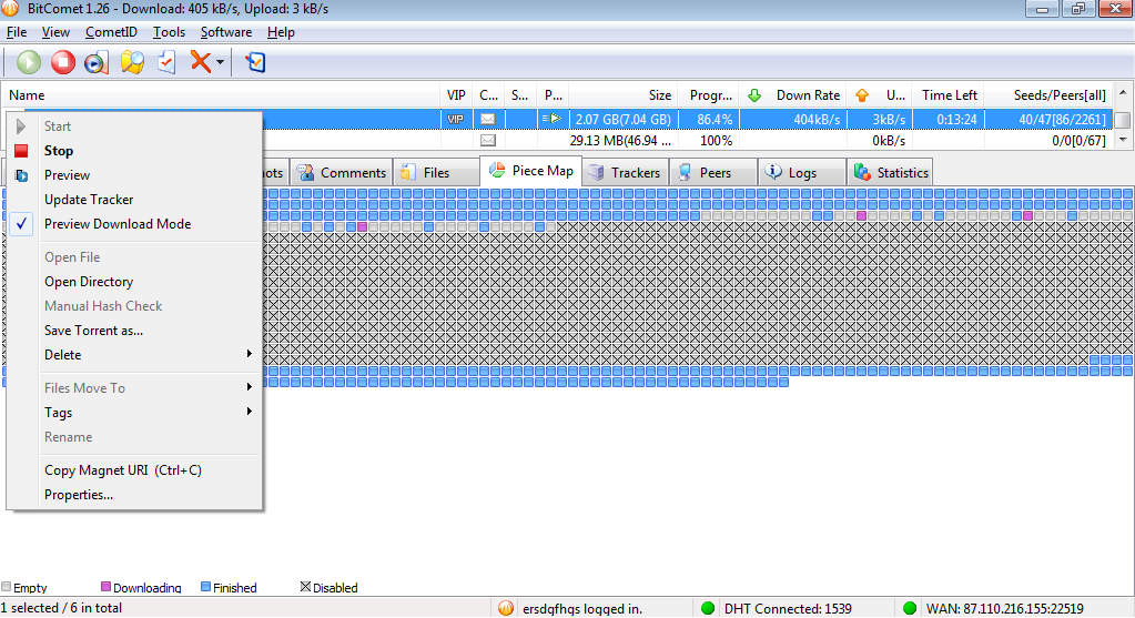

I’m attaching two screen-shots here for your amusement; I hope this will help to identify the problem.

Well, so far we haven’t established yet that there IS a problem. The screenshots you posted are not very clearly indicating that situation either, since most of the files for that torrent are disabled.
If you want to present proof of a bug you’ll have to do that with torrent s that don’t have most of the pieces disabled and also you’ll have to be able to reproduce that in more than one torrent.
As I was explaining above, this option doesn’t GRANT you absolute sequential download order for pieces (BitTorrent protocol just wasn’t designed for that) but a best-effort behavior from the client’s part.
It’s very possible that the scattered pieces which can be seen in your screenshot may have been downloaded at moments when all the peers/seeds which may have served the next sequential pieces to your client were choking you. So you client was faced with the choice of either sitting idle waiting for any peer to serve it the next sequential piece or taking any other piece which was available. In that case, the logical and most productive choice is the latter, hence the few scattered pieces you can see.
I’m not denying 100% the possibility of a bug, just saying that what you presented may have very natural causes. In order to prove a bug of this type you need to watch closely the Piece Map and *Peers *tab during the whole download. If while the seeds connected to you are NOT choking you, you still download ONLY scattered pieces and no sequential ones, then and only then can there be talk of a bug.
I hope you can understand now why this is a rather time consuming operation and not a very easy to carry out one either.
Seems to me that piece graph shows that it’s doing it’s job exactly as planned. It’s targeting only the next sequential 50-100 pieces and getting them in the order they become available. This doesn’t look like random scattered “fill” while waiting. If that was the case, it would be across the entire field, not only the immediately adjacent group of pieces. Even if it was random fill, that too would be normal and expected.
edit: I see the large block of disabled pieces, didn’t notice that at first.

In addition to the afrorementioned torrent, which is season 3 of some TV series, I’ve tried to play also with season 2, a similar torrent with about the same number of files, file size and even seeds. So:
[s3] This is what happened when I enabled all the rest files of the torrent I spoke about earlier;
[s3] This is what happened when I deleted all the files of the said torrrent and tried donwloading a single file – now it worked! (As I’ve pointed, it didn’t work before) I believe the difference between this two states of a single torrent clearly shows that something has gone wrong.
[s2] This is what happend when I started downoading season 2–a very similar torrent;
[s2] This is how it progressed and
[s2] What was it like in the end… It somewhat works.. Or not?
[s2] A single file downloads in the same way as in [s3]
The peers tab looks either like this or like that, depending on the LT Seeds option.
