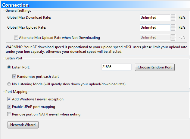

Title says it all really, here what it says;
WARNING: Your BT download speed is proportional to you upload speed! xDSL users please limit your upload rate under you line capacity, otherwise your download speed will be affected.
I haven’t been able to get over 100 mb/s for ages on bitcomet, Yet on steam I get like 5200 MB/s all the time.
Any suggestions?

17.0mb/s = 2.125mB/s or 2125kB/s, so you’ll want to limit your global max upload so it doesn’t use more then 80% of this, so about 1700kB/s would be a good upload limit assuming your speedtest is accurate.
Next, in order to get a good download speed you’ll need an open listening port, is yours open? I notice you have it set to use a random port each time, is there any reason you’ve done this? I suspect your port is blocked so anyone wanting to trade with you cannot unless you contact them first. This is probably the root of your problem and it’s a bit of info that should have been in your initial post.

But thanks for the quick reply, The reason I have random ports each time on is because sometimes my port was open, and sometimes it was not, that seemed to help but now it isn’t atall. I’ll call up my ISP now for some assistance in port forwarding then get back to you.

using random ports is a very bad idea, you should use one port and setup portforwarding in your router. I doubt your ISP is willing to help you with this, but you can find guides for most routers at portforward.com, just ignore the advertisements trying to sell you software to open the port for you, it will only further complicate things, then proceed to the guides section and it will walk you through the setup. Once complete you should have a green light on your WAN indicator, then the next step would be to adjust your bandwidth settings to match your connection speed.
