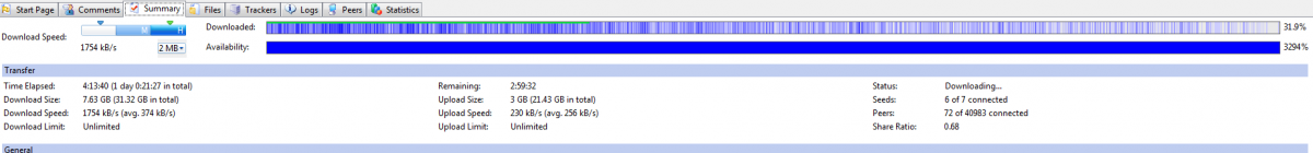

I’ve been having this issue as of late where a download will finish, and then restart back at 0%. It’s really annoying when I finish a 20 gig torrent only to have it restart and have to wait many hours for it to finish again. Does anyone know why this happens and how to stop it?
In the screenshot below, please note the stats versus the values in parentheses. It’s the current versus the running total from the restarting.

I’m familiar with the hash check, the icon is yellow while that is happening. This is not what I’m talking about. My download actually resets back to 0% and restarts all over again. Why would the stats of that torrent be the way they are in the above screenshot if not for a restarted torrent?

No, it resets back to 0% every time it finishes to 100%.
I wouldn’t say that the hash check “finished fine” then, it was a failure. Do you have bitcomet set to append the .bc! extension onto unfinished files? If so I’d try turning off this option, but first I’d look in the download folder and see what is there, it’s possible you have both the complete and the incomplete files in the folder.

Ok there was two theories I was considering. One is that something caused bitcomet to crash after it renamed the .bc! but before it marked the task as complete, so when it recovered it made new temp files, but in that case you would have both the complete and the .bc! versions. Theory two is that something happened that caused the renaming of the files to fail and the files were lost so the file system couldn’t see them, then the task created new empty ones. You could run a file recovery software to see if they can be salvaged, but first I’d recommend scanning your drive for errors. Since you’re using default settings your downloads should be in c:\downloads, so scan the C drive. A file system or harddrive error is the most obvious cause here, but if you cannot find any errors I’d try disabling the option to use the .bc! extension on incomplete files, then there will be no renaming when the task is complete.
