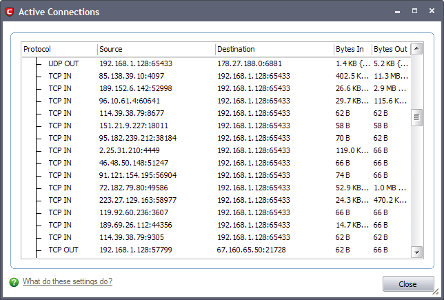

Kluelos, a TCP connection is identified by a socket (source IP:port, dest IP: port) in front of the TCP/IP stack.
Hence your system can listen on the same port for thousands of connections and create them; each of them will have a different IP:port pair at the other end, and thus will be unique in the eyes of the TCP process which handling them on your machine, even if your end has the same IP:port pair for each of them.
I don’t refute that the OS may do what you explained above under certain circumstances, but it’s not mandatory, unless multiple connections come from the same IP address (though that’s not the case in BitTorrent).
Lookie here at all the TCP IN connections reported by my firewall:
/monthly_06_2012/post-53766-0-40793700-1339031396.png" rel=“”>
