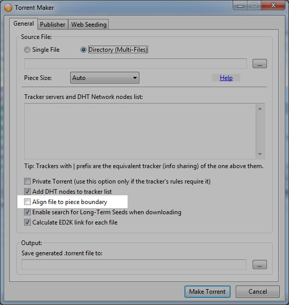

Further research on this led me to an option in the make torrent dialogue box. The " align file to piece boundary ".
I’ve learned that this option, enabled by default from version .85 creates the padding files and disabling it will stop the
creation of the said files in the torrent.
But what I’ve learned about the reason behind it’s creation now, my question to you is, will this option if disabled at the
time of making the torrent create any kind of problem, such as

This option can easily be disabled by unticking the “align file boundry” option when making a torrent.
/monthly_07_2011/post-1287-13100399619722.jpg" rel=“”>
