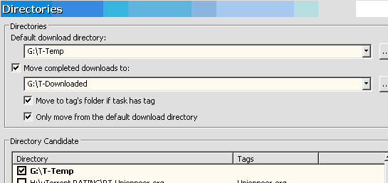

uT can move unfinished jobs to special Tags folders (I have many) only after completion of the jobs. Now on BC I have this settings:
/monthly_10_2012/post-113970-0-76737900-1351046383.png" rel=“”>
And when I add torrent-file and selecting for it a Tag (and a folder, suppose), BC asks me whether he should to move a data to a tag-folder? I say yes and he does it immediately, so I can see in that folder an unfinished jobs :o
How I have to change the settings to avoid this? I want the program to use G:\T-Temp folder for all unfinished jobs regardless of their tags. For example I have a tag MUS and this tag have a folder G:\T-Downloaded\MUS.
I’m afraid that isn’t an option. You could request it but I don’t recall anyone ever asking for this before, so don’t know that it would be very popular.
Yep, but what’s he’s asking is basically advertised by the interface except it’s not doing it that way.
I.e. the interface says “Move **completed **jobs…”
I believe this is a bug which propagated because the feature to move completed jobs was introduced after the one which allowed to move task contents to different folders based on tags.
It’s just that not many users wanted what he wants so far; that’s why not may people caught this bug before, probably.

I can’t really agree, Wiz, that the IF says it will deliver that, or that it can be clearly classed as a bug. Say rather that they are alternative ways of moving files, and lemondeal wants them to be complimentary.
Why can’t you agree? :unsure:
As you can see in his screenshot (or on the Options page) the “Move to tag folder if task has tag” is indented which clearly indicates that it’s a sub-option (a child if you will) of the master “Move completed downloads to:”.
Therefore the word of order for both options is “move completed downloads” not downloads which are in any way pending completion.
If the second option was on the same indent level as the first one I could agree with you, but then both would have to use a radio button instead of a checkbox as they would compete with each other (since they are mutually exclusive).
The entire screen is pre-empted by the OTHER option, which is to set the default save directory for files with a given tag. You can EITHER engage in this dialogue to move finished files, or you can drop down to the tags dialogue and set the save directory per tag. Nothing promises you can do both.
That probably could have been better thought out, but it probably “jist growed” since the features weren’t added at the same time, as you mentioned, so likely nobody looked at the whole process.
Either way, that does need to be done, the whole process considered and not just the band-aid suggested.The underlying conflict needs to be resolved. A redesign is required.
Now I’m understand about move to folder etc. - If I will select yes (move to tag-filder) - BC will immediately move unfinished job to a tag-folder. I need to select No, and thereby BC will move files only after the completion of this job. Is it possible to disable this window (with question move or not)?
