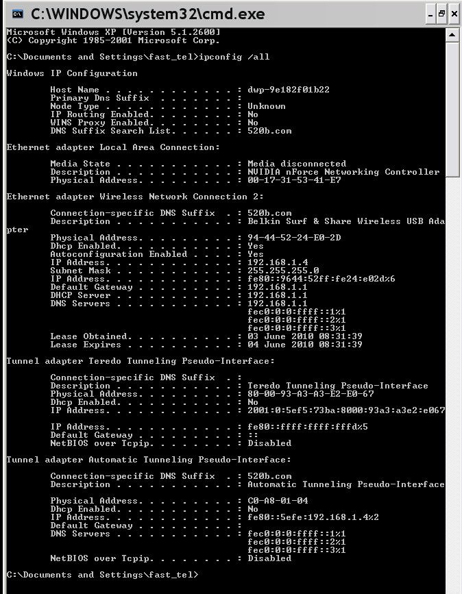

bit dave i have the same internet and wirless stuff as you do, also Soraiya, the run" cmd thing doesnt show up a screen like yours.. Also i followed all yur dteps dave in your discussion and things still are goin as slow as can be.. and since i have a nice connection it shouldnt tbe so slow. Also since i cant see the cmd thing i can t tell if i have a static i.p so i dont know what to do and i have had problems like this only other games and programs, so anything that u could o to help me would be great. Thansk a lot
Hi steroids,
Hm, can you show me a screenshot of your CMD? Because the main thing is to just see the red-boxed area.
If typing ipconfig /all doesn’t work. Try typing only
ipconfig
Does it show anything like IP address, DNS gateway, etc?
i did but the screen wil not stay open now idk wat to do/ also i belive i have a static ip now but i wasnt sure it has not changed at all in a day or 2 so idk. All i really need to do s up the speed but i dont know whats slowiing me down ive been to evry speed up site here that says it will speed it up and nothing/ I got the nat problem workin for now it just it is still so SLOW.
