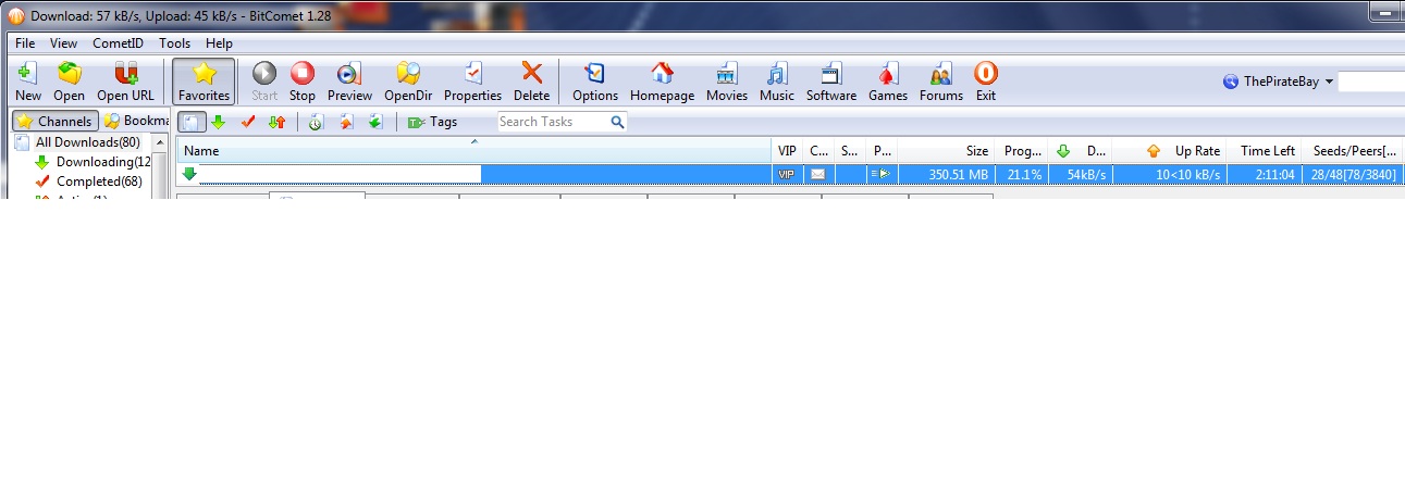

After reinstalling windows and bitcomet 1.28 i encounterd quite the problem. Namely, no matter to what vlue I limit UL/DL speed, no bandwidth is left. Even tasks alone breach the limit, but the main problem is that that it slows down all other internet stuff. Network meter clerly shows that no bandwidth is left, but returns back to 0 when i exit bitcomet. It’s not a router problem, as it works just fine on other PC’s and no settings have been changed.
the numbers:
DL/UL limit @ 60kB/s
actual network traffic: variable, from double the limit up to 350 kB/s. My connection allows up to 450, but has to share it with TV, so effectively with TV on i have 180 kB/s left.
See the difference between limit and actual value…
now, how do i fix this? it is possible as I stated some lines up.
thx
post if you need aditional info

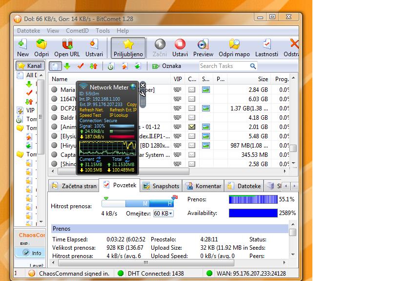

Bitcomet itself shows no significant traffic over the limit, but netmeter says something different, as seen in attachment. I hope i’m hovering over the correct stat, but on other hand, every one of them shows the same.
btw, i noticed that net meter scale is missing, it spans 0-180 kB/s. No other programs were running when print screen was taken, for further reference… After reinstalling twice more (current and also print screen state), it’s not so obvious anymore, before it was just a bit saw-like around 160 kB/s compared to shown in attachement.
Judging from the bitcomet installer, could it be that installed files are not actually checked? Meaning it believes windows saying all files OK and makes no hash cheks? It seems as if something was corrupt when extracting (with the instaler), and a single reinstall didn’t help (had to do 4 for effect, but it’s still not perfect)

I suspect the difference between the two is the method of measuring. Your netmeter program shows spikes that are high, assuming they are accurate, they still don’t account for bandwidth usage at that level. BitComet (correctly) attemps to average your bandwidth to the guidelines you set, but if you were to look at the raw data, you’d see it higher one instance, lower the next… this is unavoidable.
I think to get an accurate test to determine if bitcomet’s readings were accurate you’d need a program that shows average speed, not peak speeds.
this net meter also shows average speeds, not shown on screen capture above. I’ll repeat this, right now the difference between peak/low is quite large, but when i started this thread, it limited around 160, and average showed that. Also, I cant reproduce the problem in such magnitude anymore, now it averages at 120, sometimes 90, meaning it’s not a priority problem anymore.

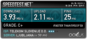

bandwidth isn’t a problem

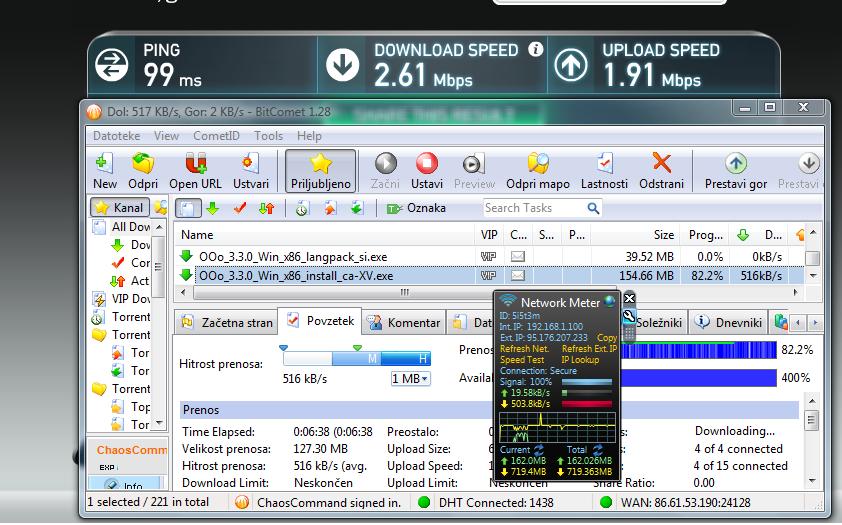

According to your test, you have a maximum download speed of about 490kB/s. Let’s try an experiment, download a torrent from openoffice.org here. Set bitcomet’s download limit to unlimited and run the torrent. With nothing else using your bandwidth, you should see bitcomet using most of your 490kB/s (probably about 450), and if netmeter reports higher, then you know it’s faulty. On the other hand, if netmeter reports 490 and bitcomet reports much less, then this may require further research.
Save screenshots of the process in case we need to alert development of any potential problems.
did as told
with bitcomet running
/monthly_08_2011/post-73200-13125841377617.jpg" rel=“”>

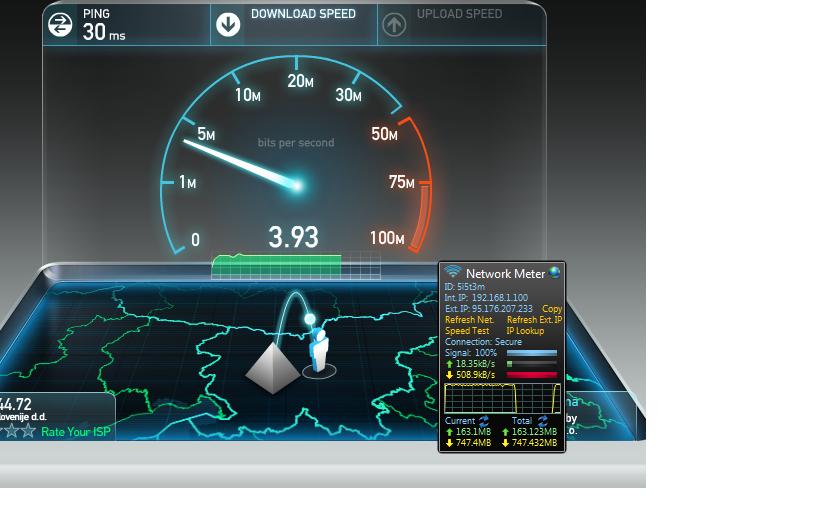

I’m intrigued… how does this show anything? speedtest got slower results as bitcomet was using bandwidth, right? also, bitcomet shows higher speeds than net meter.
(3.93 mbps=503.04kilobyte per second) so bitcomet shows wrong values here (you claim it’s accurate?).
now, just for my info, i started speedtest without bitcomet running (to get actual download speed) and watched the net meter. netmeter was off by 5 kBps wich i deem within the tolerance area.
also, i think this has nothing to do with my issue that is, bitcomet uses up 3 times more bandwidth than what it shows
/monthly_08_2011/post-73200-13125841443607.jpg" rel=“”>
Your tests show that bitcomet is using as much of your bandwidth as possible on the openoffice torrent, slightly higher then the speedtest indicated, clearly showing the speedtest was conservative, but this isn’t unexpected.
What it does show is that the amount of bandwidth bitcomet reports is accurate. If it was reporting less then it uses, then it wouldn’t be reporting 517kB/s, since we know that this is approximately the max your isp will allow.
