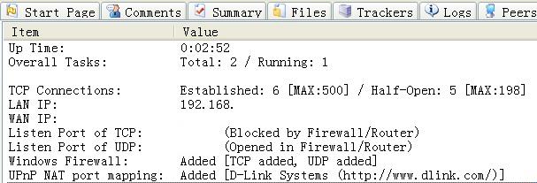

I recently changed to use a dlink router, so, I setup the port forwarding as before, but this time, the UDP is open, the TCP is blocked.
Is there any suggestion?

If you forward the ports manually you don’t need UPnP, disable it in BitComet.
DLink has one messed up forwarding menu. Every time I had to configure one of those I found it extremely counter-intuitive and cumbersome.
My advice would be to try using the Virtual Servers menu instead of the Port Forwarding one.
Make sure you set up Traffic Type as “Both” and fill in the rest of the fields exactly as you did in the current one.
See what you get.
Also make sure you have opened the port in every firewall you have running, including Windows built-in firewall.
Many a person has spent hours banging heads against router configuration, only to find that there was a software firewall that needed to be configured or removed.
Try changing to any random port in the 50,000 to 60,000 range, then adjust all your settings in router and firewall to match. See if that makes a difference.
Hook the computer directly into the modem and change the IP setting to DHCP.
Do you get an open port?
If the issue you’re having under this situation is that the UDP port is open, and you’ve proven that, for a given IP address, but the TCP port is closed, then from what you’re showing us I’d say there must be another firewall in there. Firewalls don’t cooperate with each other or announce their presence, so you can have a dozen firewalls running in software and not know it.
It’s good advice to start by getting the router out of the loop temporarily, and connect directly to the modem. IF the port is still blocked, then you know it’s something running on the computer that is doing the blocking, and you’ll have to find and fix it. If the problem goes away, on the other hand, then you know the router was still misconfigured and that’s where you need to look.
