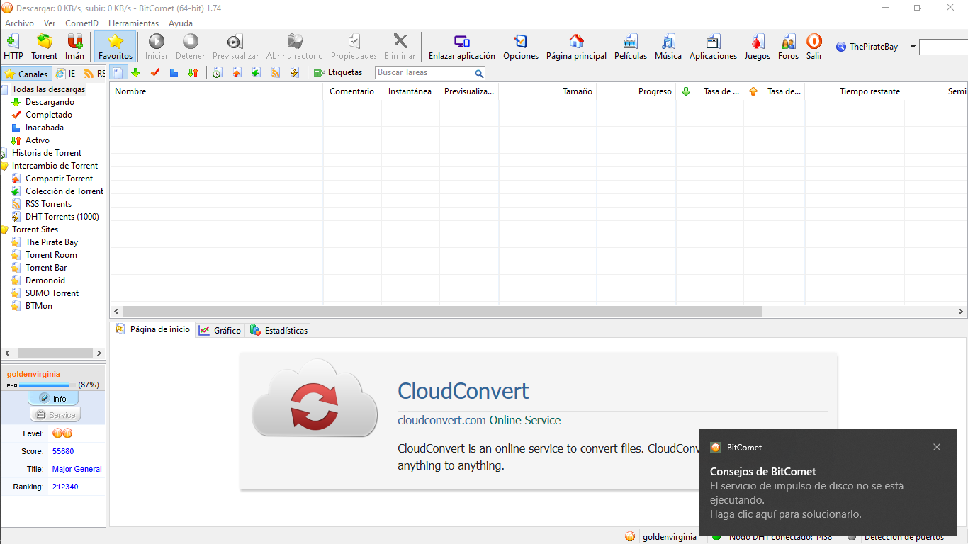

- Ver captura 1 " Consejos de BitComet El servicio de impulso de disco no se está ejecutando Haga clic para solucionarlo"

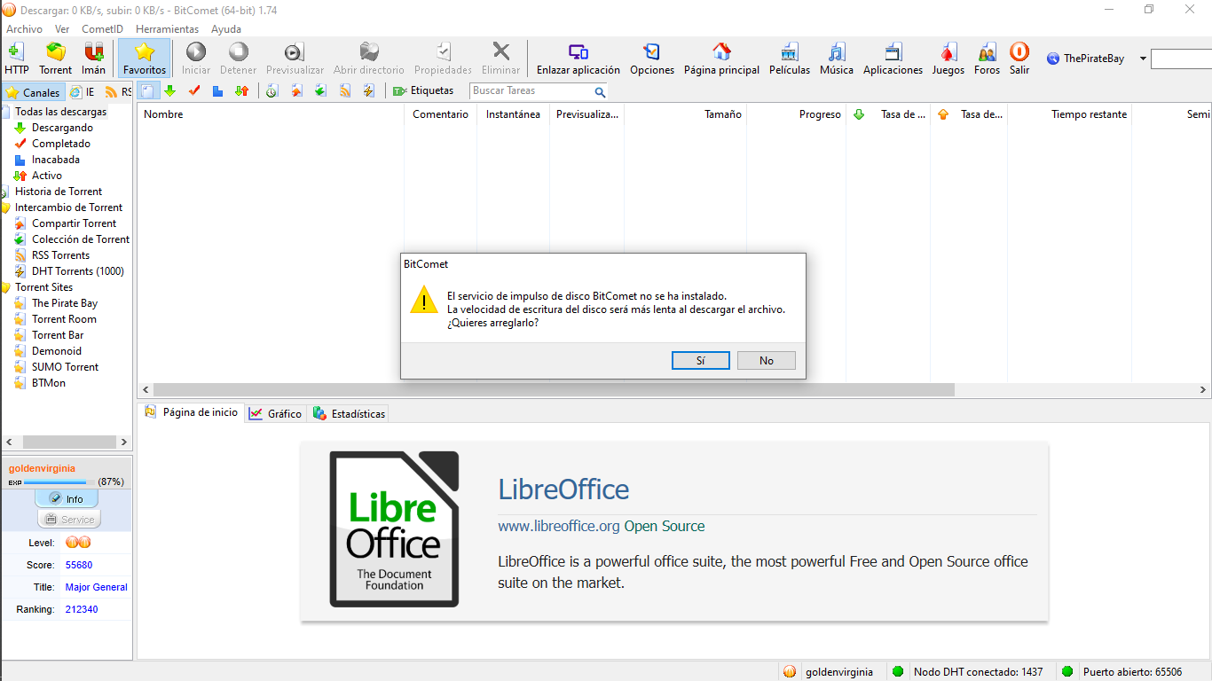

Hago clic y, siguiente captura 2, " El servicio de impulso de disco Bitcomet no se ha instalado La velocidad de escritura del disco será más lenta al descargar el archivo ¿Quieres arreglarlo?"

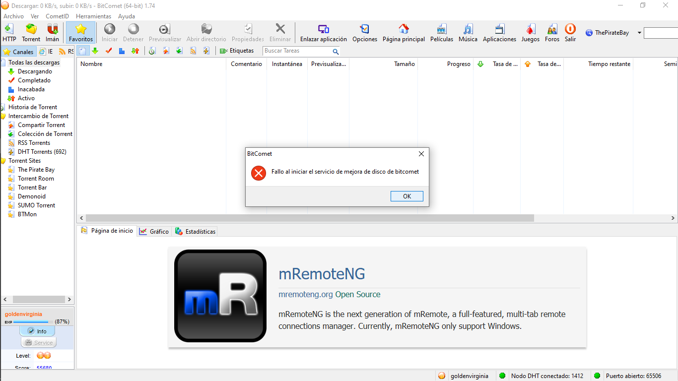

le digo que si dos veces y , última captura, "fallo a iniciar el servicio...."

Recently, I did clean install of  the OS (Windows 10 Pro 20H2) and when I start BitComet I get a notification which I've never gotten before, in all of the many years of usage and installations of BitComet...
Take a look at screenshot 1..."BitComet Advice: The [disk impulse] service is not working. Click to fix it." *(Sorry, I'm not sure about the technical translation for this - **cassie**)*
I click and (screenshot 2) and "The disk impulse for/of BitComet has not been installed. The write speed of the disk will be slower when downloading the file. Do you want to fix it?"

I tell it 'yes' twice and (last screenshot) I get "Fail when starting the service...".
