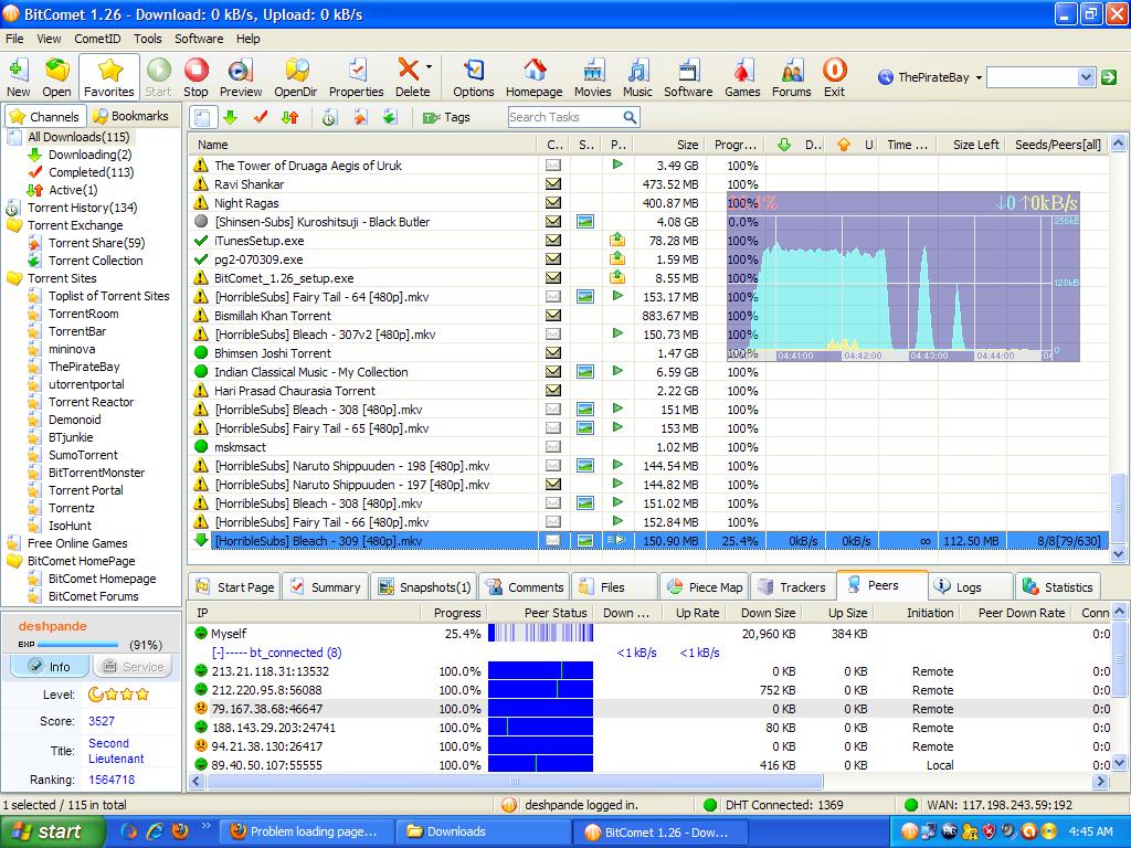

i am trying to add screen shot but it is not accepting it.
It shows below{near the attach this file button
“Used 9.48MB of your 10MB global upload quota (Max. single file size: 535.39K)”}.There are only 3 posts here…
how can i add the screen shot of the problem?

i added 2 screen shots. You can see clearly in the screen shot The floating window how the download increases and drops continuously also in one shot there just 8 peers and the other has 40 peers.
/monthly_02_2011/post-58260-12979948133251.jpg" rel=“”>
/monthly_02_2011/post-58260-12979948389848.jpg" rel=“”>
Hmm. In both of those torrents, your upload speed is zero. However that came about, it makes you a very undesirable trade partner, which would soon bring your download speed to near zero as peers decide not to spend any more bandwidth on you.
So the question becomess, why is your upload speed zero?
ya, i agree…if you see the floating window carefully the upload has been taking place in small patches and also amount of upload is very less.

The question still remains though: why is your upload speed at zero in those screenshots? IT should not be unless you’ve set it to be so, but that will definitely kill your download speed.
Indeed, you can try that for yourself by setting your global max upload speed to 1 KB/s (Don’t set it to 0, that means “unlimited”). You’ll find this exact situation happening before long, that your download speed drops to zero because nobody wants to trade with you. So this is where you should focus your investigation.
